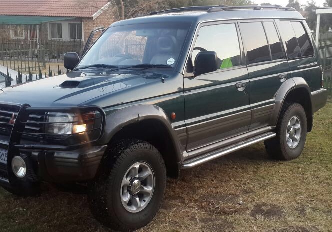

Im looking at buying a lwb gen 2, 2.8 at the moment, and I'm hoping to get some advice from from the fundi's, so please bear with me as i ask 100s of questions.
The vehicle I looked at is a 96 model, but has a number of features that make me think it is an import, such as heated seats, electrically adjustable shocks, and rear difflock. If it is an import, will i still be able to source parts from the agents if i need to, or will i be politely told to buzz off?
The car doesn't have a service record, and i am aware that there is always an inherent risk in buying a high mileage diesel. What i need to know is if there are any tell tale signs that will tell me the pin has been pulled on the grenade already. What i have noticed is that the car starts easily and does not smoke, the radiator has been replaced by silvertons, so it no longer has the plastic header tank, and the cylinder head is also cleaner than the rest of the engine which i assume means that it was replaced at some point as well.
There are a few things wrong with it, the first being the dash lights. When i engaged 4wd , the abs light came on and wouldn't go off again, what can this be? The lights showing the front wheels are being driven work fine when i engage 4wd, but flash constantly when i put it back in 2wd. I have read that this is most likely a faulty solenoid. Are they easily obtainable and do you have any idea what they cost, as the agents refused to assist me without a vin number?
The rest of the faults are more electrical. The rear left window does not work at all, the rear right only operates from the drivers control panel, the demister switch has fallen apart, and the electric window switches on the drivers armrest have so much play in them, they feel like they are going to fall apart at any moment. Will i be able to get second hand switches, or is it a common problem meaning that the used ones will also be faulty?
The handle by the numberplate light, that you use to open the rear door is broken. This looks like its going to be hell to replace, and I'm guessing is only sold as a complete unit making it expensive. Is that correct?
Aside from this, it is in good condition for its age, and only needs new tyres. What would you think is a fair price for this vehicle?
Thanks in advance
Conrad

Hi forest fab,
Thanks for the feedback.
Youre right, I have already bought it, and it's definitely a grey import. Unfortunately the previous owner didnt even know it was an import and couldn't tell me how it came to be in the country. Strangely it does have the lights in the bumper, but it also has rear heater, as opposed to the rear aircon, so Im guessing it came from somewhere colder like the uk?
Gulp, you're right at £150 i wont be buying any adjustable shocks. I still need to have the shocks tested, but im pretty certain that after 350k km, they will need replacing, but i will most likely get monroes or gabriel safaris.
With regards to the electric windows, its turned out to be multiple problems. I've had to replace both rear door switches, plus the left rear motor to get everything working again.
After a lot of reading on the overseas forums i have found out that there is nothing wrong with the abs. Abs doesnt work when you engage 4wd, so the abs light comes on. The light will only go off again when you turn the ignition off.
I havent yet had a chance to check out any of the mechanical components that may be casuing the flashing 4wd lights. I have tried things like reversing, changing while moving slowly, and while stationary , but none of those of managed to stop the lights flashing.
Ill post some updates of the progress in the other thread i started when it stops raining and i can take some decent photos
