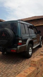

After a lot of debating, I decided to buy the Pajero i had asked for advice on previously. She is a imported 96 model 2.8 diesel with 350 000km and this will hopefully by the story of how she is brought back to her former glory.

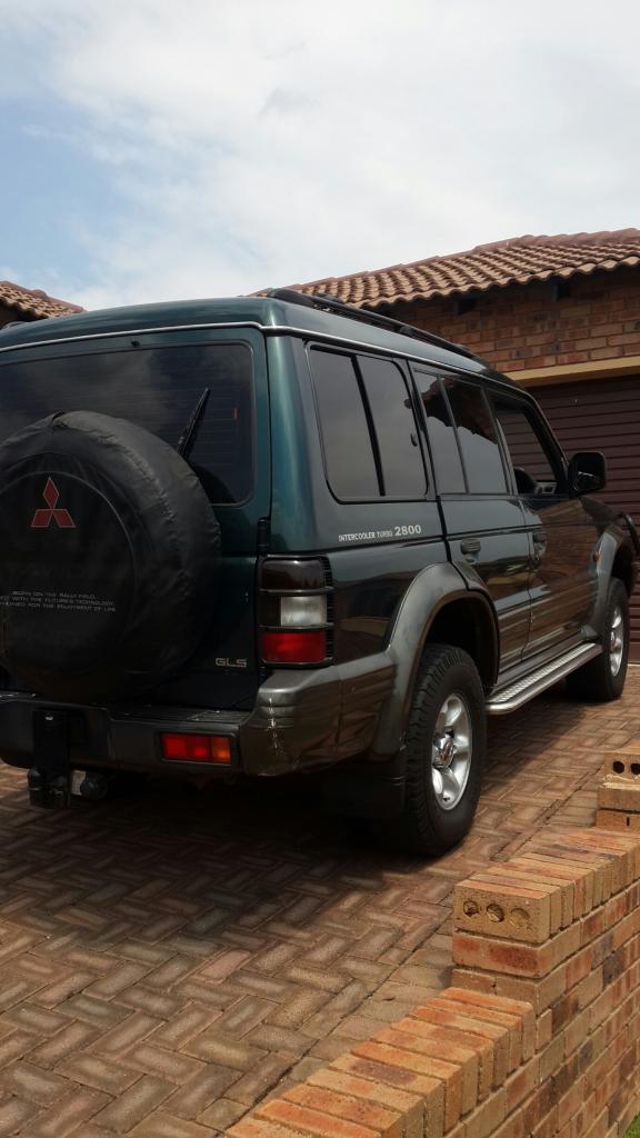

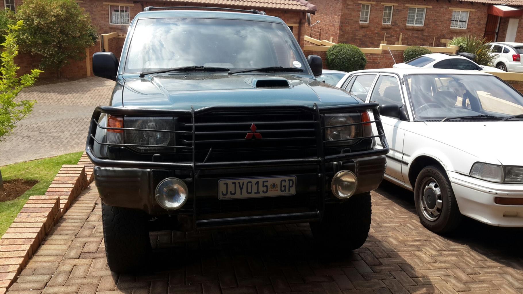

Here she is when we first got her home:

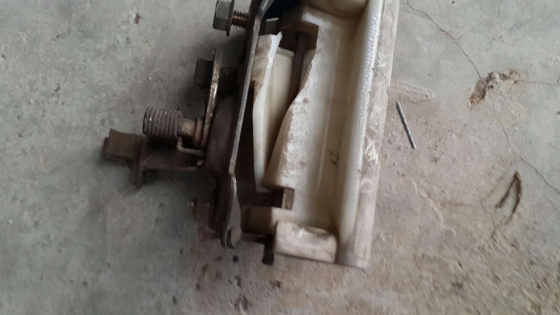

As to be expected with a car her age, she has a few issues. which need to be sorted out before she turns into a competent overlander. The first is the rear door handle, which was broken. A visit to Martins Pajero graveyard in Pretoria secured me a new one and a few other odds and ends, like pedal rubbers, door knob and rear window switches:

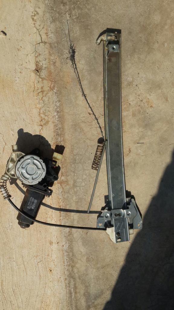

The other things on the to do list, are have a new cable made for the electric window:

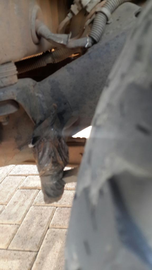

Get new rubbers for the rear stabiliser bar, as duct tape may stop the rattle, but it doesn't enhance the performance

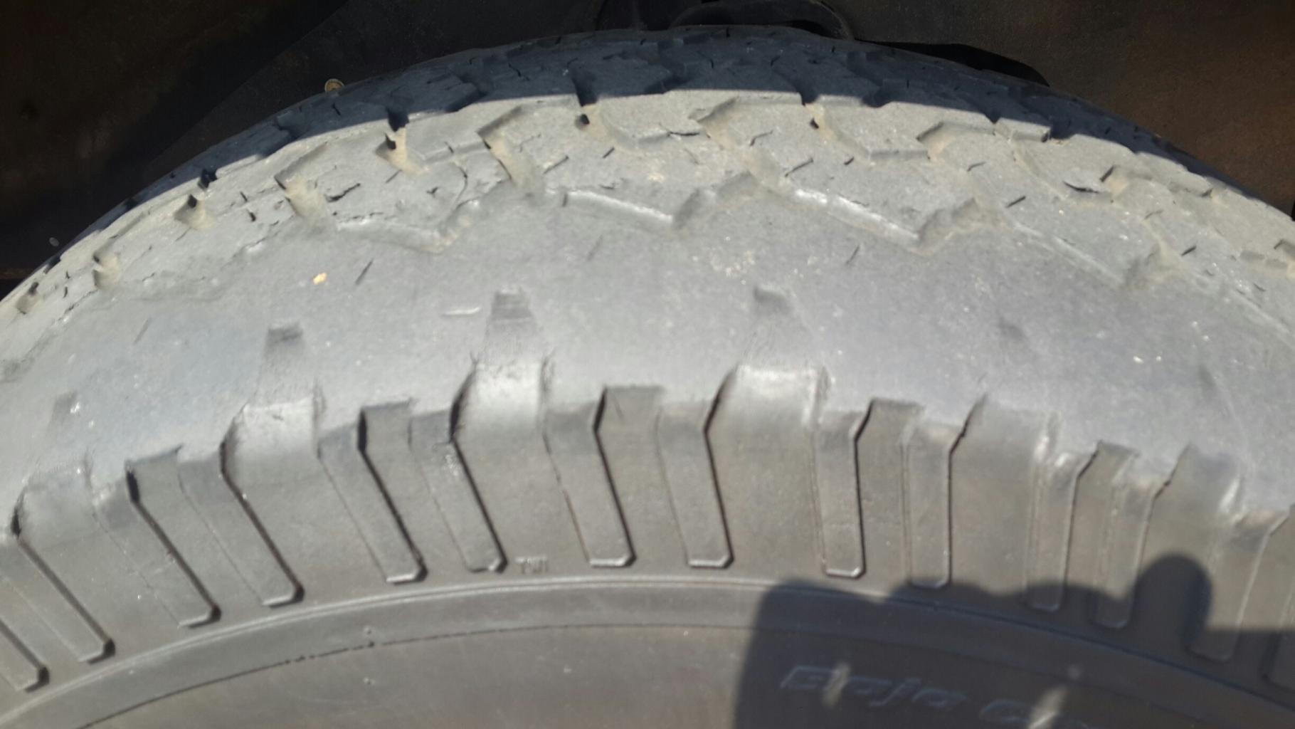

It needs new tyres and wheel alignment:

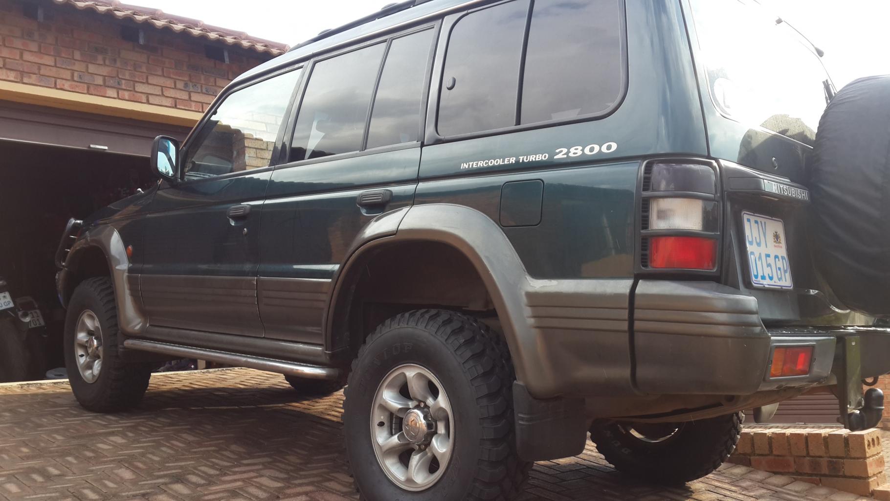

So the pajero got some Christmas presents. Some new tyres, patrol springs at the back and some ball joint spacers in the front.
I tested her out to hobby park today, and she did really well. I just need to get the front torsion bars re indexed as they have run out of adjustment, and then get the alignment done

Just a correction on my previous post. It turns out the torsion bars didn't need to be reindexed, there was enough adjustment left in them. I think the tyre fitment centre technician thought they were maxed out as the threads were old and dry making it hard to turn. I cleaned the adjusters up with a wire brush and some Q20 and adjusted them before having the alignment done. She now sits 79mm high in the front and 83mm high at the rear.

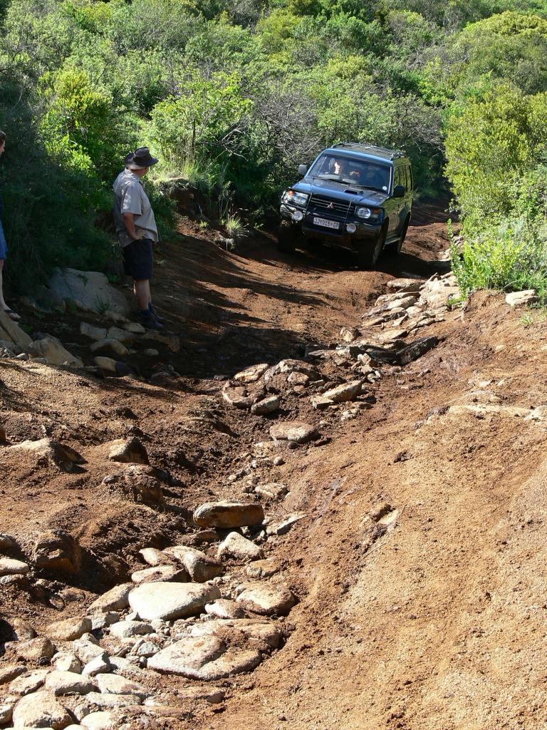

After all that work, I needed a holiday and we took her through to the 4x4 community get together at 3 provinces. She really impressed, never giving me a minutes grief and didnt get stuck once.
