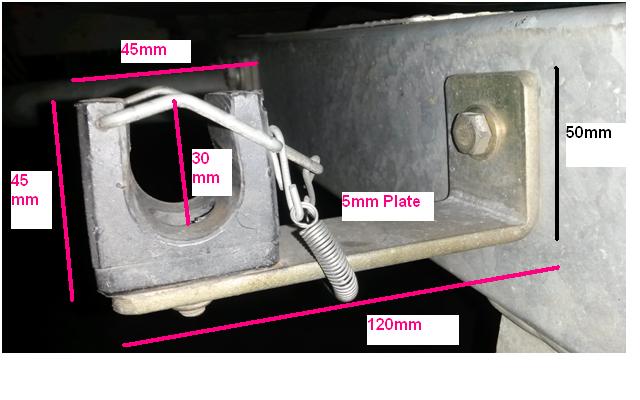

Hi guys, I am in bit of a bind, i stupidly went and sold my caravan without removing the stabilizer bracket…this was a year ago.
I bought another and want to fit my trapezium stabilizer…I can manufacture the bracket quite easily, if I had the dimensions.
Could someone with a trapezium stabilizer fitted to their caravan, please measure and post the dimensions of the bracket (or email to me aajv22@gmail.com)
Greatly appreciated

Hope this will help.
Not sure how you'll manufacture the hard rubber bit at the end.
I thought I had an extra bracket from a service exchange unit which I got some years ago, but I can't lay my hand on it right now. Will keep looking.
Let me know if you need more measurements.

Johan,
Many thanks, you went into a lot of effort providing such a detailed photo, I greatly appreciate it This is all I needed.
