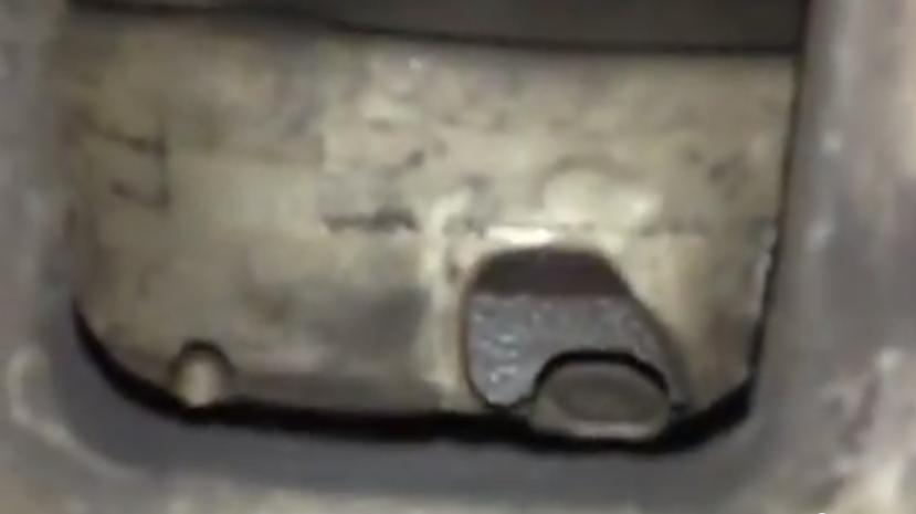

I think you need to release the gearbox as per this method due to the pull type clutch.
Releasing the quick connect quick disconnect pull…: http://youtu.be/vKmUoWaybes
Re: Problem with engine removal
Ah!
My Pajero being a bastard between a Gen1, Gen2 and a Colt (as far as clutch assembly goes), I was not aware of that fancy clip goodie! :D
If that works, fine.
If not, my method will still work.
One of the bolts I refer to can be seen at 1:29 in the video:

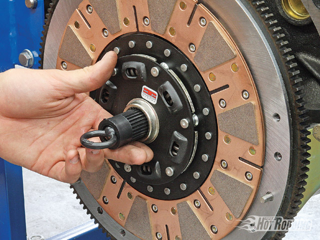

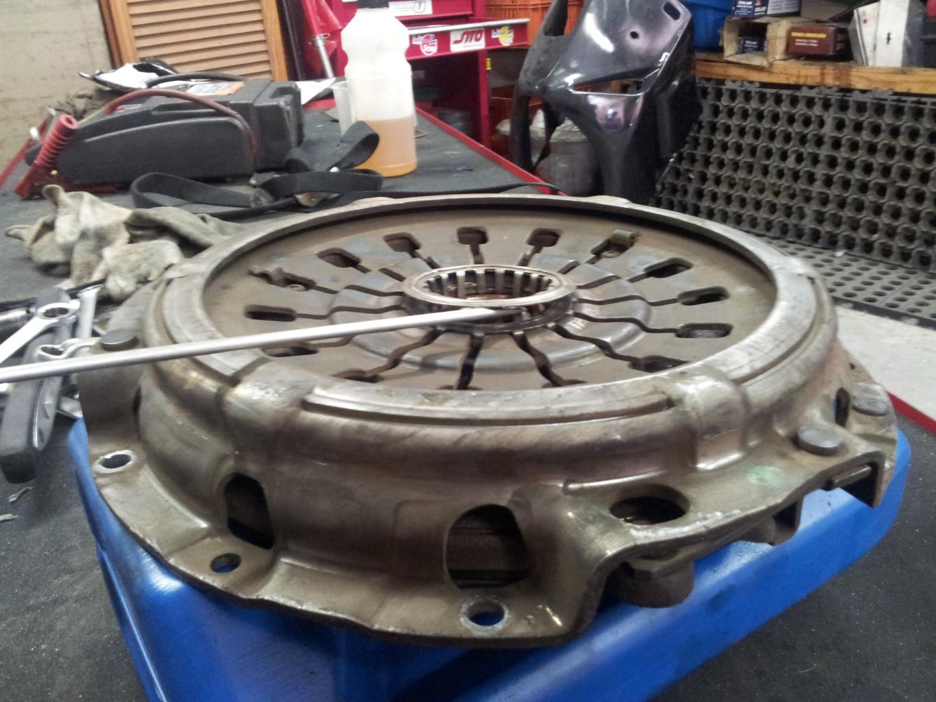

The dismantling method I described can be used (in reverse obviously) to install the clutch plate and pressure plate.
This is how you do it:
  1. Assemble the (always new!) release bearing, pressure plate and clutch plate onto the transmission main shaft.
    No alignment is necessary.
  2. Install a new spigot bearing into the crankshaft.
  3. Mate the transmission to the engine. The only thing to worry about, is to get the main shaft into the spigot bearing (it helps to close your eyes! :D )
  4. Once the bell housing is in place and tightened, you simple install and tighten the bolts holding the pressure plate to the flywheel.
I have never installed a clutch assembly as easily as this!
