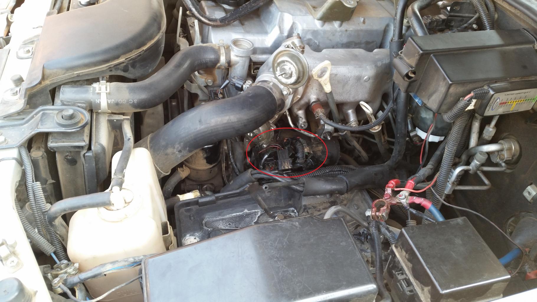

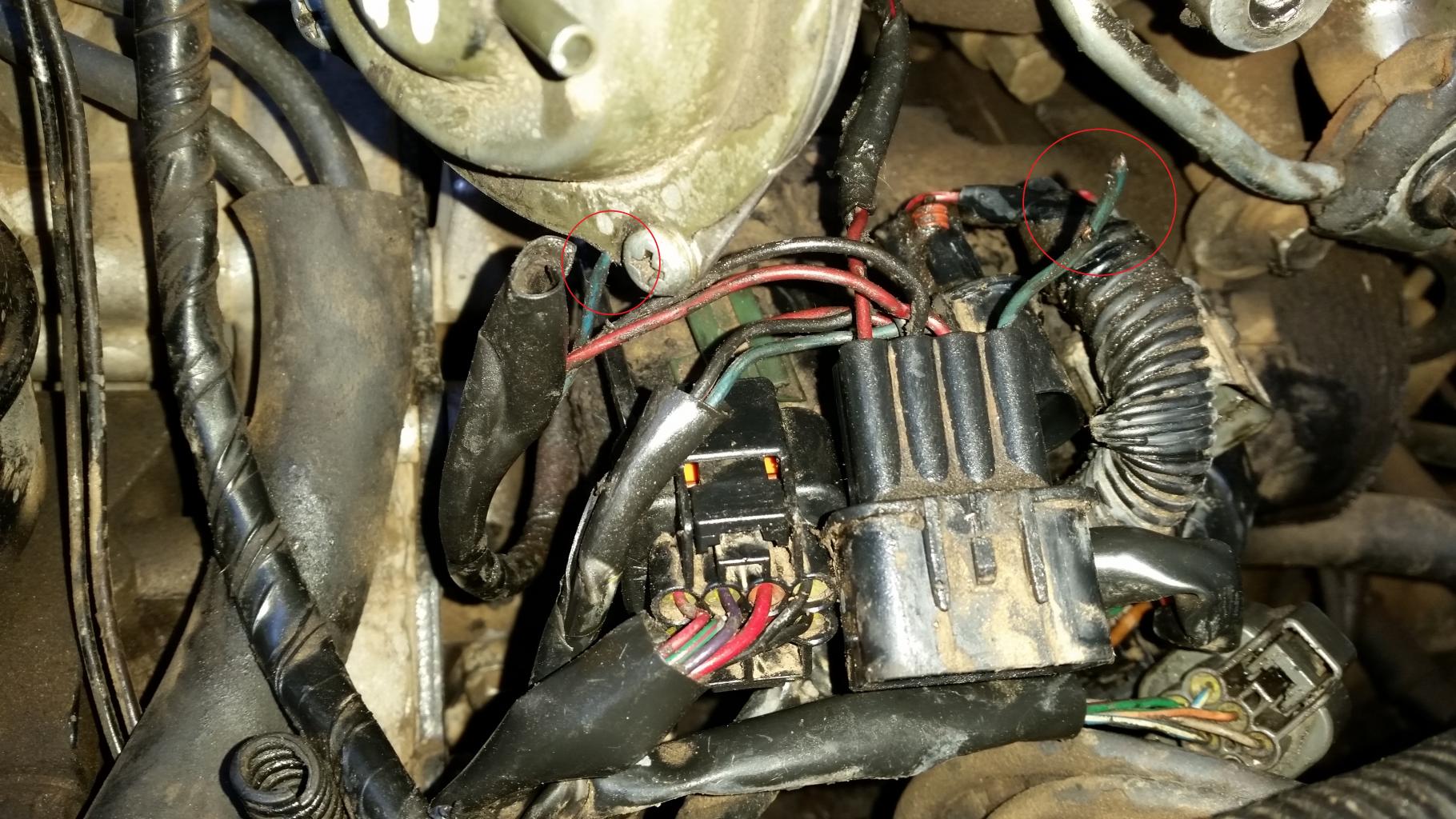

After my car started dying and spluttering and rev counter jumping up and down, and idling uneaven, revs just climbing and and and, I assumed petrol in diesel, this never happened, there was never petrol in my diesel, went and confirmed with footage and slip recalls, so after everyone everywhere kept saying it MUST be your diesel pump or your injectors and wanting R1800 to put it on a dyno just to start with, before anything else has been done and R650 fault computer at Mitsubishi and and and and and......I would like to just say YOU can all go and F#$K yourselves !..... People just don't care anymore, everyone just want to screw each other over and take your money.....im disappointed that this forum could not be of more help, i can not believe that no one has ever has the same symptoms as me, but even so, i got one or two reply's wishing me luck!...really?....
ANYWAY......The fault on my car was ONE SINGLE WIRE !......everything that I mentioned and explained and all the fault codes and and and and....was one f@#king wire........I can only imagine how many people have had the same problem and have had their diesel pumps redone or apparently redone and injectors apparently replaced only to have had a single wire or a few replaced because of a short or no contact. This wire was still slightly making contact but also on the body and shorting and it caused major malfunctions, I just happen to play around with that plug over the weekend while STILL driving my car and breaking down and standing nexto the highway, because i refused to believe its the diesel pump or injectors, moved the plug a bit and she ran fine till it bumped or moved or whatever, then same problem...so this morning moved the battery and checked the plugs, and the wire just broke off, so it was just just hanging on for dear life....fixed it, joined it....ans she runs without skipping a beat !!!!....the frustration the last few weeks has been ridiculous!....I hope this post helps someone who finds or will find them self in this situation !

Hi Desmond. I am absolutely sure if someone on the forum had or even knew of a similar experience, they would have shared it with you. We are all learning as we go, and share gladly when possible. Symptoms you describe could be anything from a faulty sensor to a dud pump, it is very far from a 'cut and dried' operation to troubleshoot these pumps when they start giving issues.
