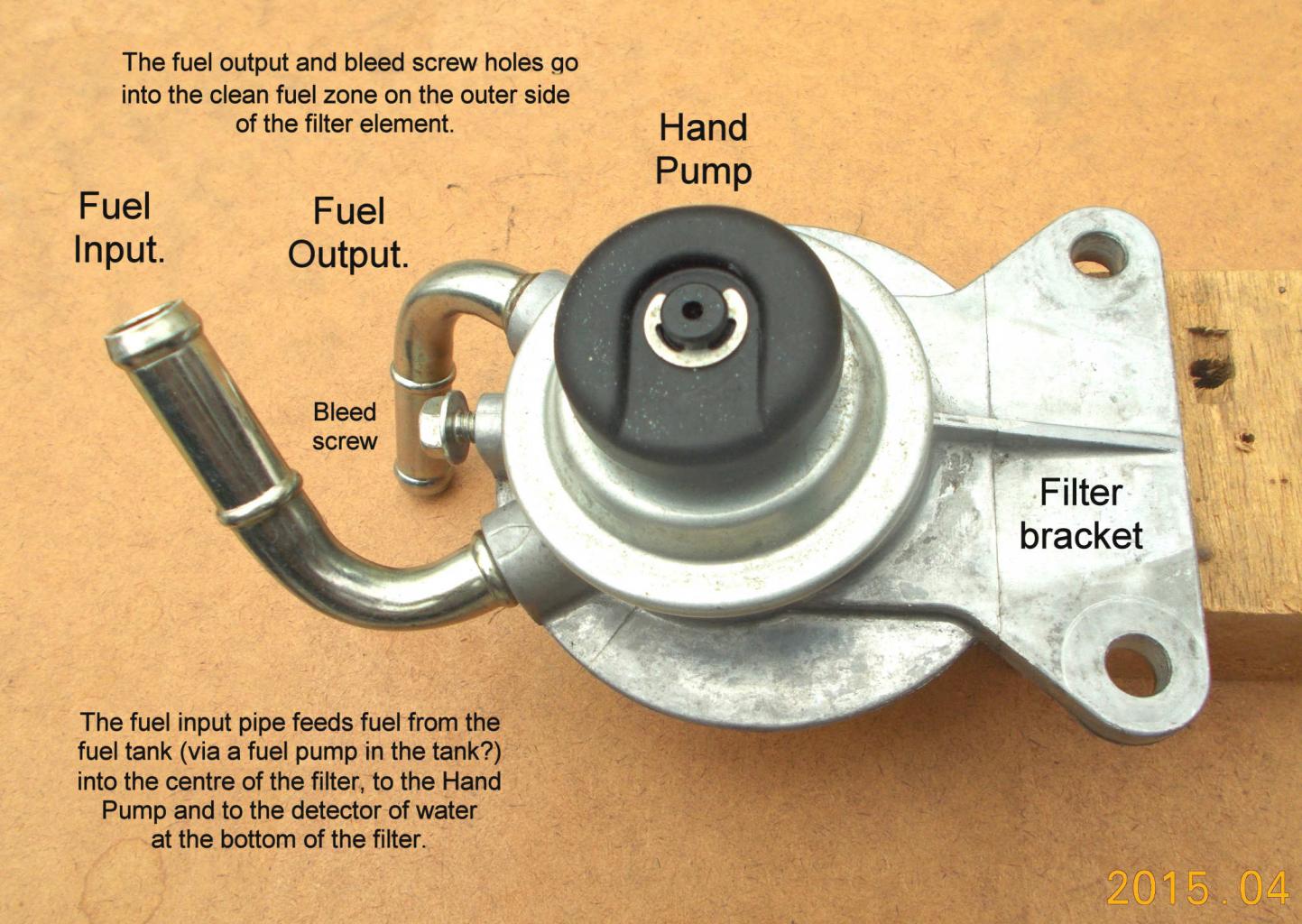

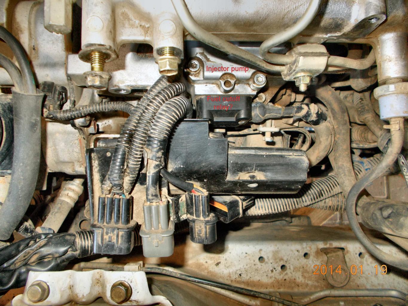

Is this the fuel cutoff relay?

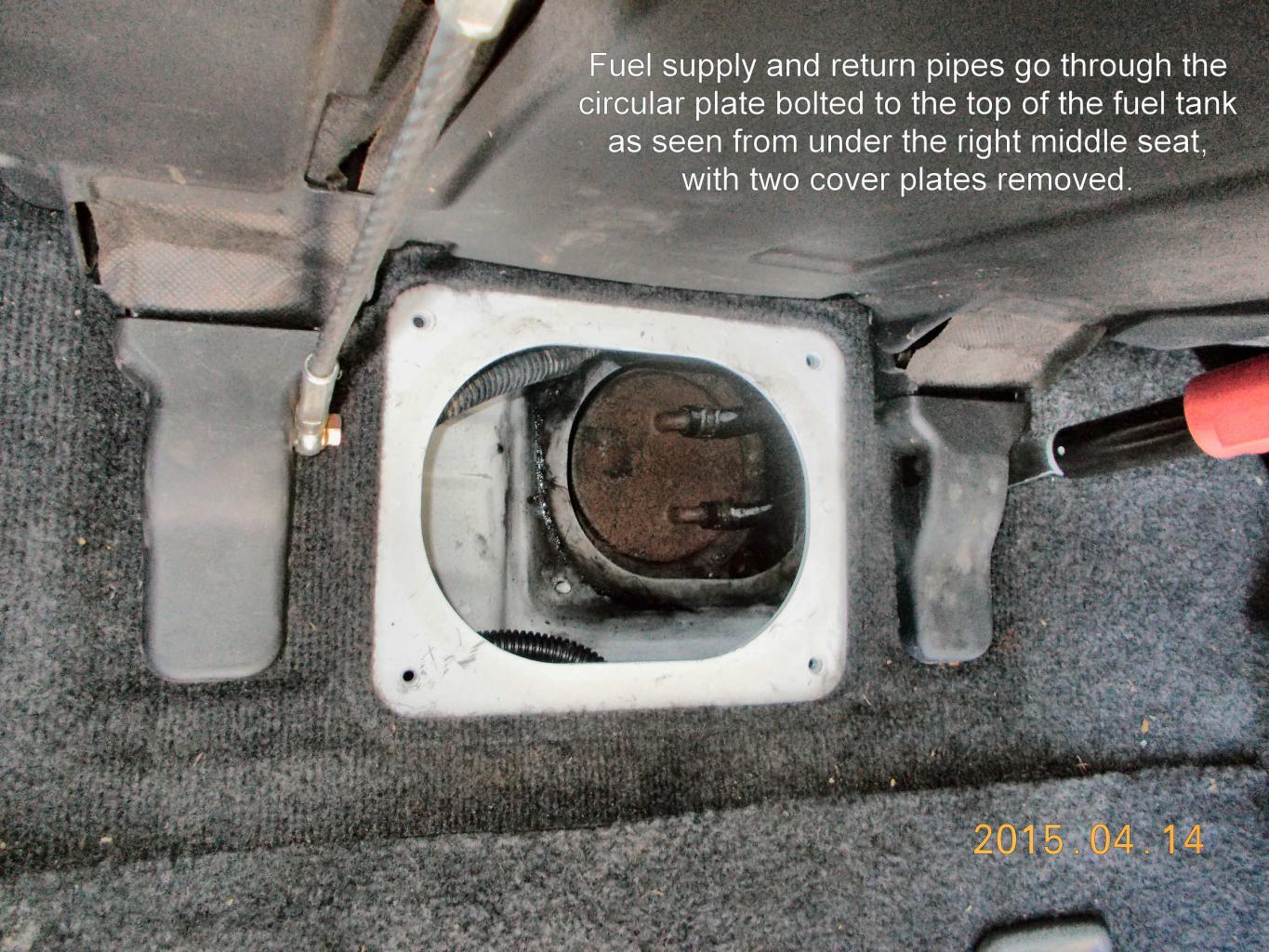

Under you middle row if seats if you have a LWB, you will find an inspection cover under which you find the fuel tank level sensor and pickup. Give the strainer a good clean and make sure there is clearance under the pickup to the tank bottom.

Ps. In your photo, the item you labelled injection pump is actually the GE (governor electric) actuator on-top of the pump, and the black box is not the fuel cut off relay, it's the GE actuator ROM module. See my post (injector pump burnt out) , that is the item that got fried on my Pajero.

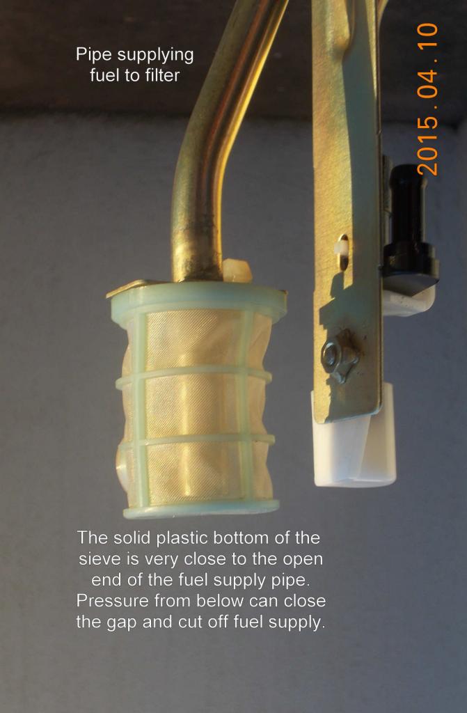

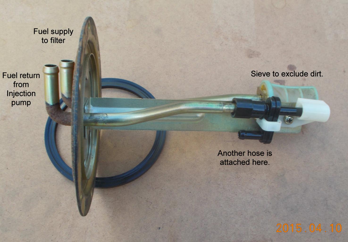

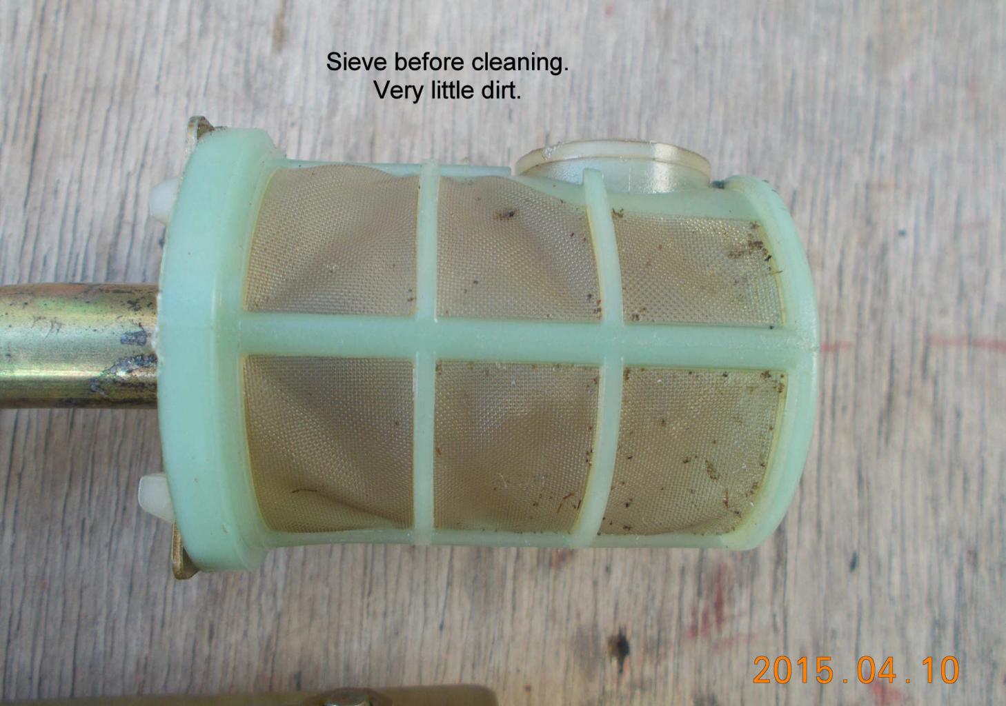

Nick Gibson and Andrew Ashton, thank you both for your invaluable inputs. I removed the 2 plates under the right hand middle seat to give access to the top of the fuel tank. After scrubbing and hosing sand and pebbles off the tank I dried the area and removed the plate through which the pickup and fuel return pipes go down into the tank. This of course confirmed that there is no pump in the fuel tank, which is why no fuel came out of the supply pipe at the filter when I turned the ignition on. The second critical discovery was that the rather delicate plastic seive which keeps dirt out of the fuel supply pipe had been squahed upwards enough for its solid bottom to contact the open end of the fuel pipe going to the filter in the engine bay! You were dead right! The bottom of the tank has been bent upwards. That is why I could not blow or suck through the pipe from the filter end! Because the fuel pump at the injector pump was sucking hard this would explain air getting into the fuel supply, perhaps through hose connections and acting like a vapour lock.

In-tank fuel pi[e assembly

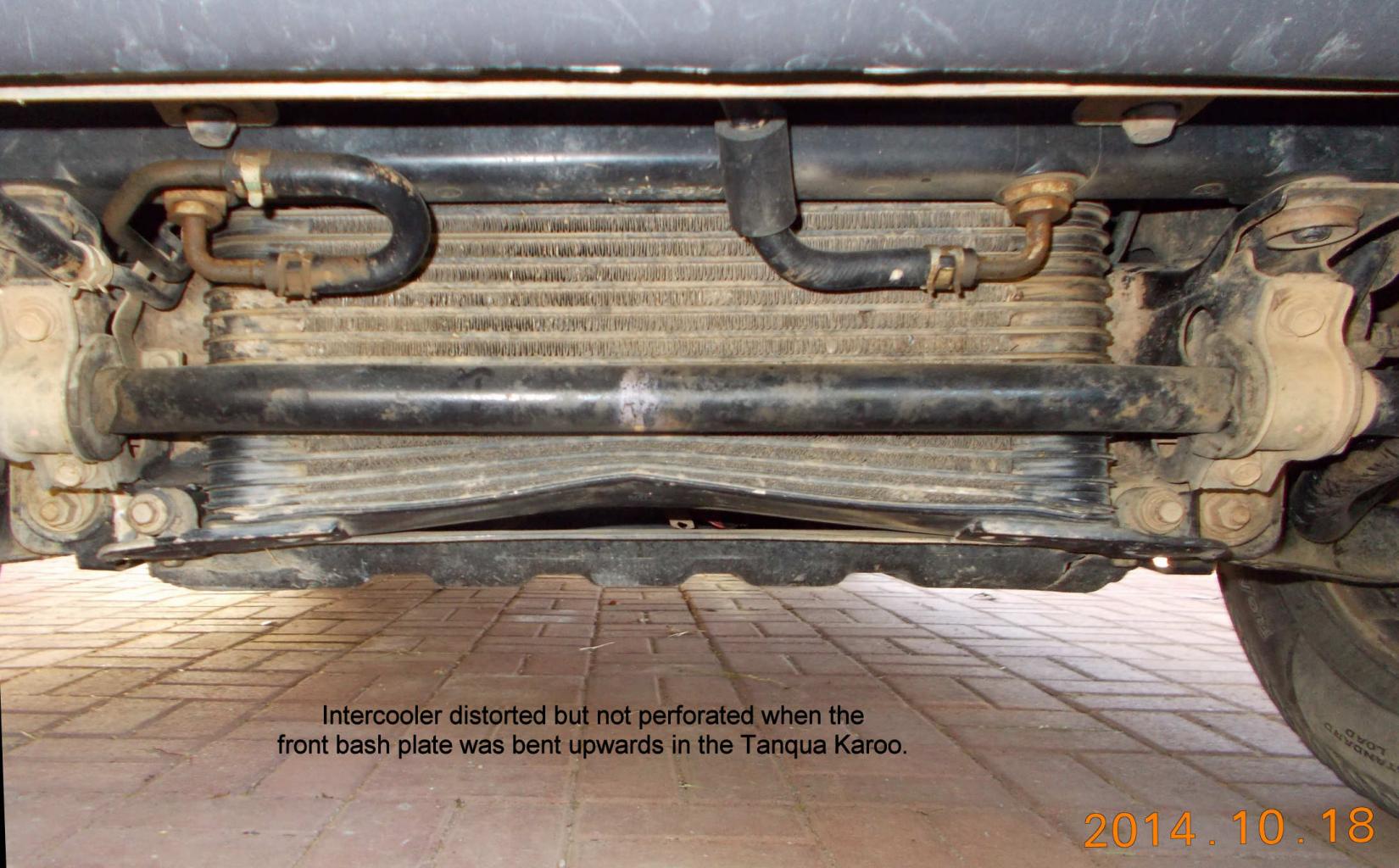

Intercooler damage
Intercooler damage
Sieve before cleaning
Fuel cut off by dented tank

1. The fact that your fuel issues are tank suction related is great news (compared with other possibilities!).
2. If you are going to do a tank job yourself - try not to damage the lining, because it seems possible that that becomes a point at which delamination can start. Anyway also check for the state of the lining while you have visibility of this - looks to be OK from the state of the in-tank filter.

4. Ditto re the intercooler - Silverton / another competent local radiator repair shop should be able to sort it out. It will be quite restricted and less efficient as it is.
5. Maybe time for a stronger bash plate!

Please dont forget to check the fuel filter bracket (with hand pump).
I have got a similar symptoms that yours on both my Pajero 3.2 DID and my 2nd generation Pajero 2.5 Tdi. After few hours of stop the engine wont start, after air bleeding the engine starts well. It was the hand pump the problem origin !
The problem was solved by the fuel filter bracket replacement on both my Pajeros :D

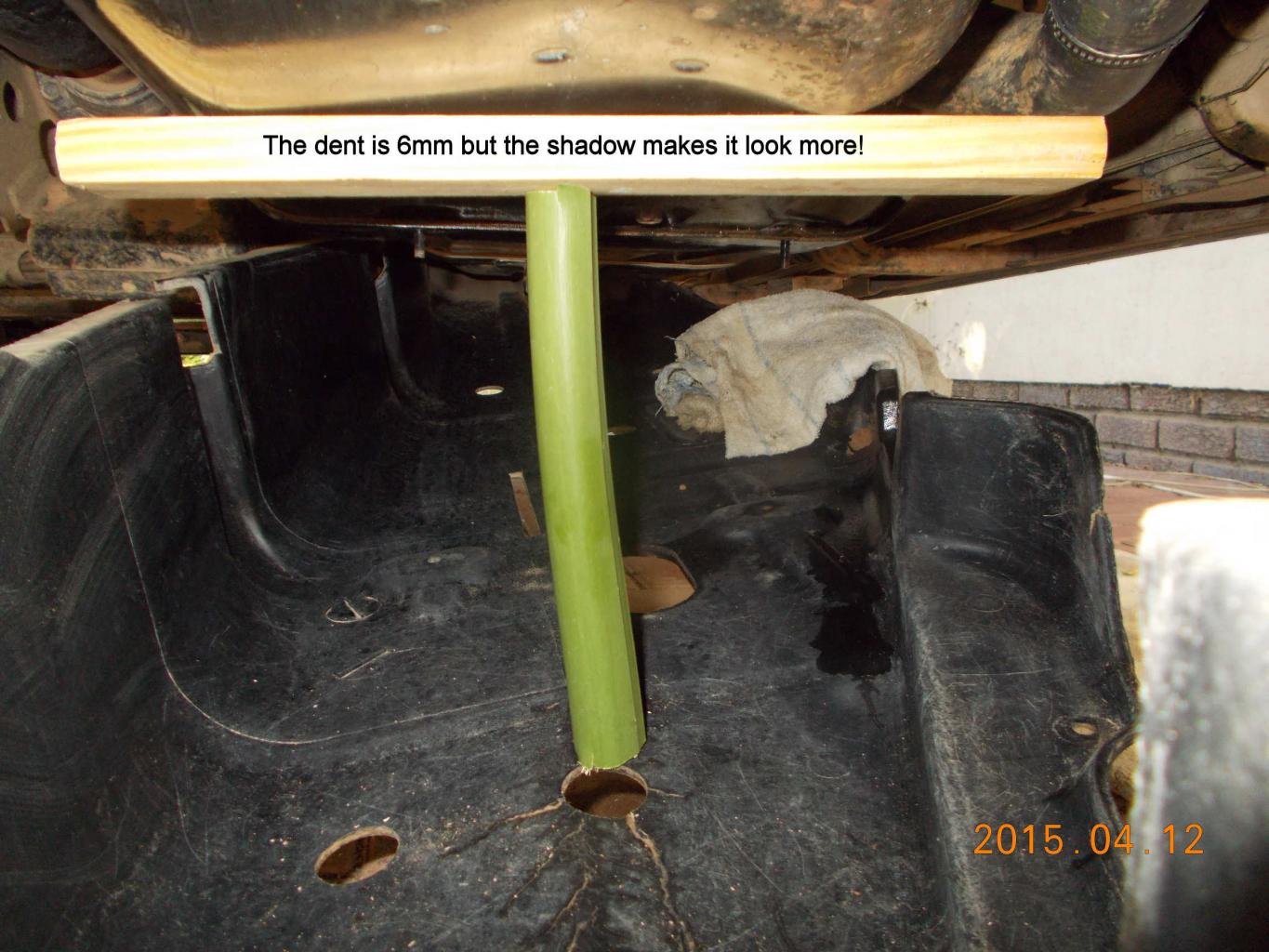

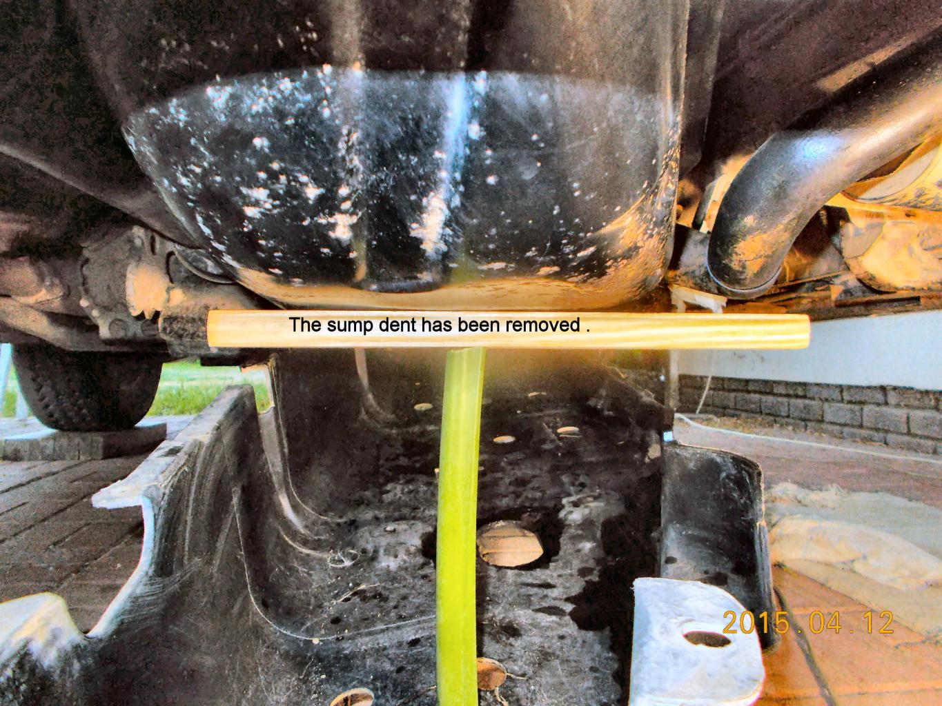

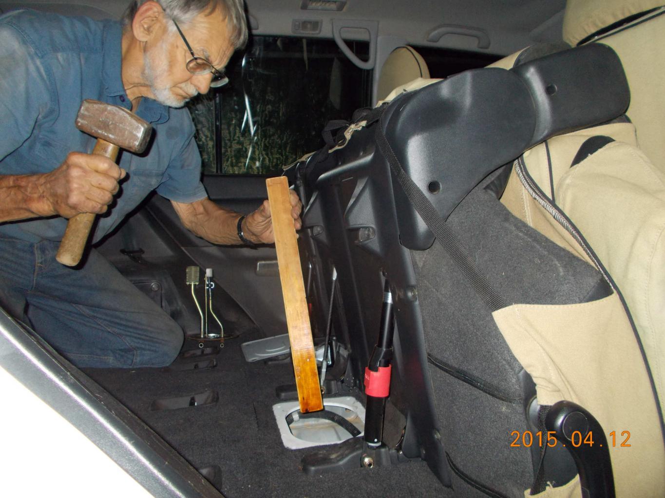

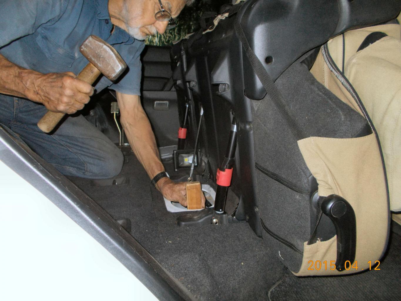

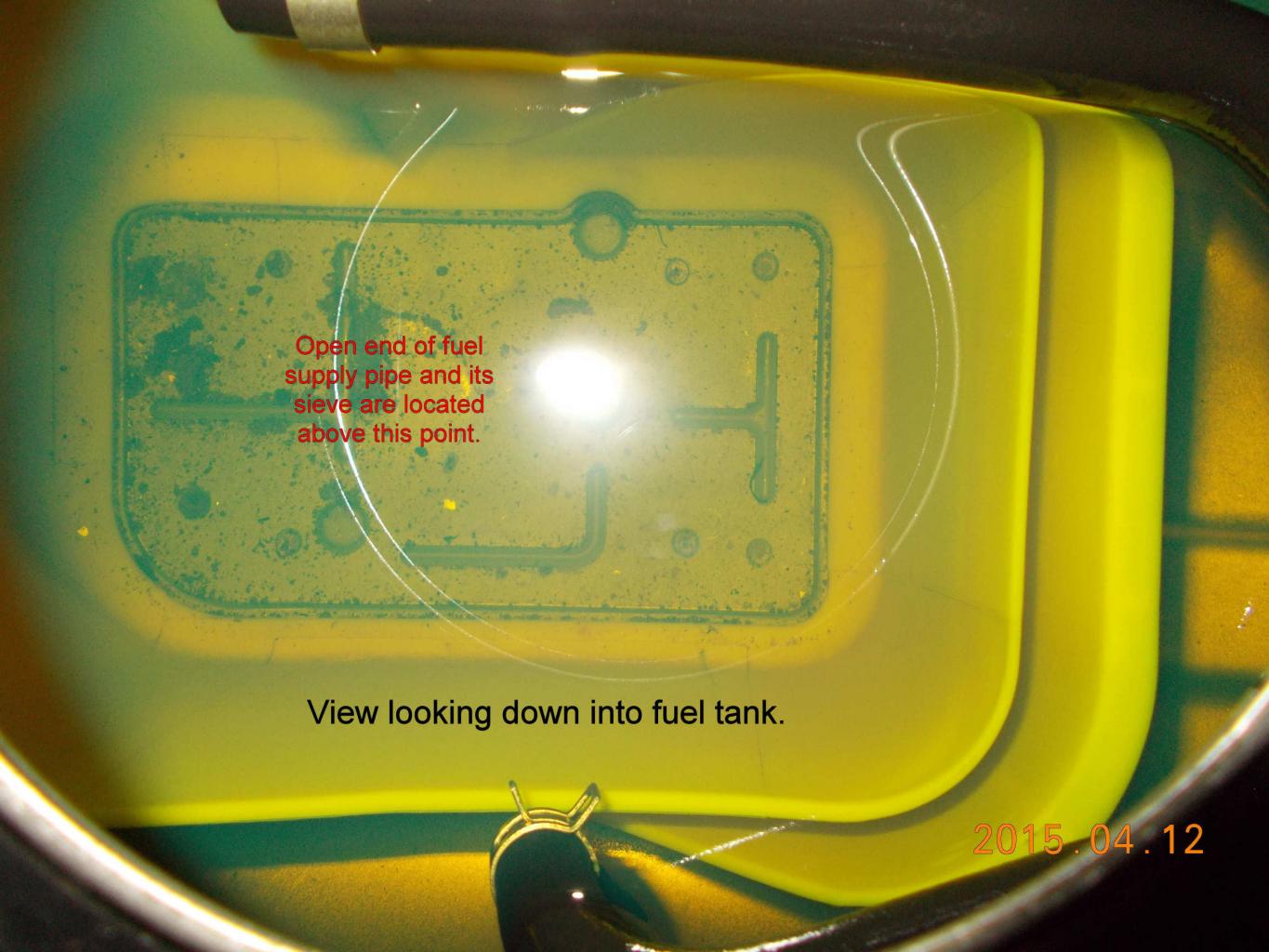

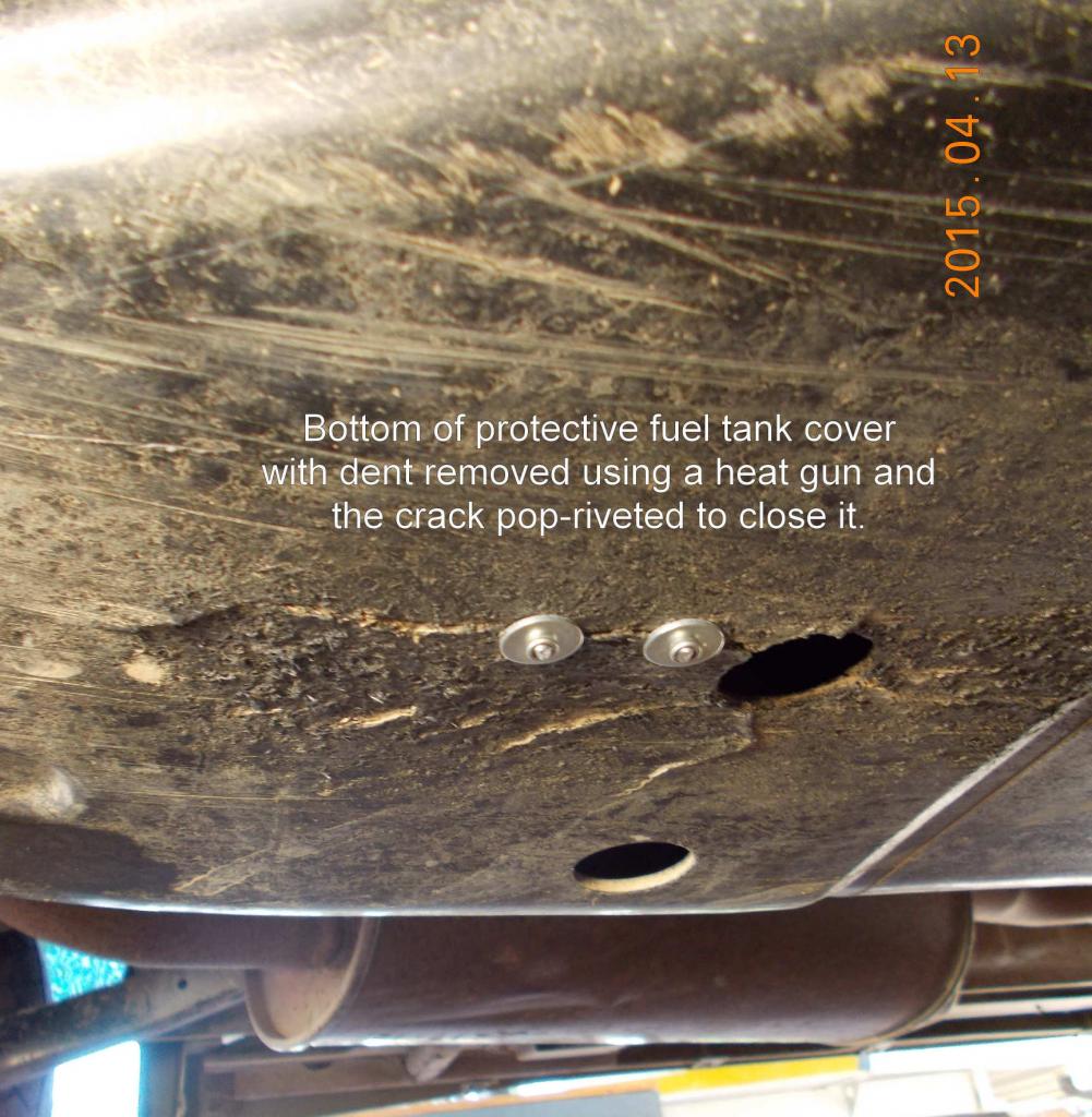

With the two cover plates under the right middle seat plus the fuel feed and return pipe assembly in the tank removed, it is clear that the tank bottom is accessible for repair. The extent of the dents is shown by using straight edges in some photos. Using a clean plank of 22x43x465 mm and a 4 lb hammer I was able to bump the tank bottom downwards in the critical area under the open end of the fuel feed pipe until it had a slight bulge downwards.
The protective cover under the tank could not be completely removed without lowering the cross-member supporting the transmission, so access was difficult. The cover had also been distorted upwards and badly cracked in the process. However, It was possible to reshape it using a heat gun (with a piece of steel plate on the upper side to avoid heating the tank) then pressing down on the cracked area with a piece of wood. Unfortunately the crack tended to open so I used two stainless steel pop rivets with washers to hold it closed. To keep the upper surface as smooth as posible the rivets were inserted from above.
After reassembling all items I went back to the engine bay to fill the fuel feed pipe before attempting to start the motor. Having detached the filter hose from it, I used transparent 12mm PVC tubing to suck on the pipe, and this time it was not blocked! After considerable sucking fuel appeared in the tube. By rapidly reconnected the filter hose before much fuel could run back into the tank and bleeding the filter and pumping till there was resistance, the motor started without any delay. As far as I can judge the problem is now fixed.
For you guys who have had similar fuel feed problems, like the motor simply cutting out while driving, the test for a dented tank causing the problem is so simple! Just see if you can both blow and suck through the fuel feed pipe where it goes into the filter. If the problem were loose dirt in the tank, blowing should clear it, after which you should be able to suck some fuel before it blocks again.

Awkward access to fuel tank
Bottom view of repaired cover
Dent removed
Dent removed
The shadow exagerates the 6mm dent
Bashing the dent
Bashing the dent
Using longish plank for repair
View of tank bottom
View of tank bottom
