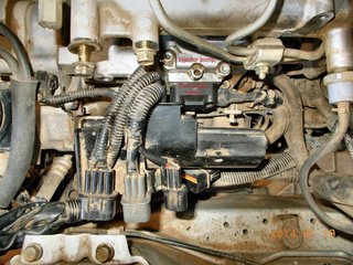

Is this the fuel cutoff relay?

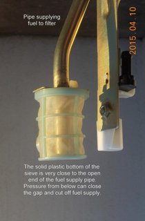

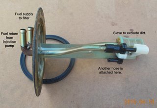

Your 4m41 does not have a lift pump in the tank. it has a fuel pickup with a mesh strainer in the middle of some plastic baffles in the bottom of the tank. It delivers the fuel via a vane pump on the side of the injector pump which essentially "sucks" the fuel from the tank via your fuel filter, and delivers it to the high pressure chamber in the pump for injection.

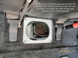

Under you middle row if seats if you have a LWB, you will find an inspection cover under which you find the fuel tank level sensor and pickup. Give the strainer a good clean and make sure there is clearance under the pickup to the tank bottom.
A big problem with our Pajero's is the risk of denting the fuel tank on a rock and obstructing the fuel pick up strainer.

Check the in-tank filter.
Given that you say you can't suck / blow the supply line to the engine bay filter.
The tank lining has been known to flake off, and the flakes can then block the in-tank filter.

Ps. In your photo, the item you labelled injection pump is actually the GE (governor electric) actuator on-top of the pump, and the black box is not the fuel cut off relay, it's the GE actuator ROM module. See my post (injector pump burnt out) , that is the item that got fried on my Pajero.

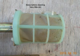

Perhaps check the sediment in your fuel filter for evidence of that.

Nick Gibson and Andrew Ashton, thank you both for your invaluable inputs. I removed the 2 plates under the right hand middle seat to give access to the top of the fuel tank. After scrubbing and hosing sand and pebbles off the tank I dried the area and removed the plate through which the pickup and fuel return pipes go down into the tank. This of course confirmed that there is no pump in the fuel tank, which is why no fuel came out of the supply pipe at the filter when I turned the ignition on. The second critical discovery was that the rather delicate plastic seive which keeps dirt out of the fuel supply pipe had been squahed upwards enough for its solid bottom to contact the open end of the fuel pipe going to the filter in the engine bay! You were dead right! The bottom of the tank has been bent upwards. That is why I could not blow or suck through the pipe from the filter end! Because the fuel pump at the injector pump was sucking hard this would explain air getting into the fuel supply, perhaps through hose connections and acting like a vapour lock.

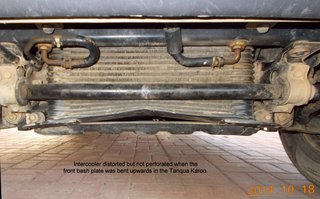

A recent case of damage to the fuel tank happened as follows: In September 2014 we stayed at the Langkloof campsite in the Tanqua Karoo. The gravel road is good but has some very severe speed bumps. With my attention elsewhere I hit one of these at 30 to 40 km/h. The car left the ground completely and came down with a crunch on the slight middelmannetjie. The front bash-plate was bent up enough to push the lower part of the Intercooler upwards by about 4 cm, but apparently it was not holed - see photo. On examination it seems that the fuel tank and its protective cover were also dented.

In-tank fuel pi[e assembly
Intercooler damage
Intercooler damage
Sieve before cleaning
Fuel cut off by dented tank

2. If you are going to do a tank job yourself - try not to damage the lining, because it seems possible that that becomes a point at which delamination can start. Anyway also check for the state of the lining while you have visibility of this - looks to be OK from the state of the in-tank filter.

4. Ditto re the intercooler - Silverton / another competent local radiator repair shop should be able to sort it out. It will be quite restricted and less efficient as it is.
5. Maybe time for a stronger bash plate!

With the two cover plates under the right middle seat plus the fuel feed and return pipe assembly in the tank removed, it is clear that the tank bottom is accessible for repair. The extent of the dents is shown by using straight edges in some photos. Using a clean plank of 22x43x465 mm and a 4 lb hammer I was able to bump the tank bottom downwards in the critical area under the open end of the fuel feed pipe until it had a slight bulge downwards.

For you guys who have had similar fuel feed problems, like the motor simply cutting out while driving, the test for a dented tank causing the problem is so simple! Just see if you can both blow and suck through the fuel feed pipe where it goes into the filter. If the problem were loose dirt in the tank, blowing should clear it, after which you should be able to suck some fuel before it blocks again.

Awkward access to fuel tank
