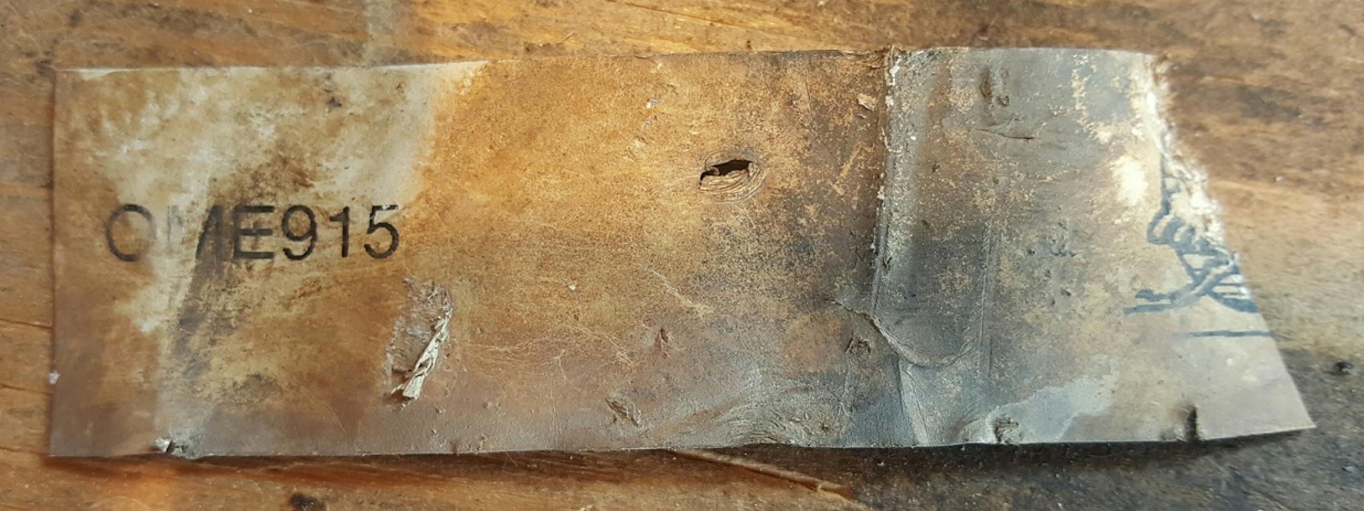

I had to change a left oil seal on my front diff, and I found this sticker on my coil spring.
OME915
OME915
Look like the original owner (Before Skillie) had Old Man Emu (OME) fitted (2915 at the front) - I need to see if I can see what he put on the rear as I cant see any stickers remaining.
The spec on page 132 of "OME_guide_current" says for the rear:
1. 21mm Dia for the 2917 (up to 200kg permanent load)
2. 22mm for the 2918 (200-300kg permanent load)
3. 22mm for the 2995 (+ 300kg permanent load)
