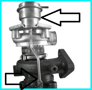

This was a second hand engine and chances are the turbo boost control system was damaged. If the waste gate does not limit / control the turbo boost pressure, the ECU will throw out an overboost fault.
Check the linkage for damage from the boost pressure control housing to the waste gate.
Check the small short rubber vacuum pipe from the turbo compressor housing (big shiny silver / inlet side of turbo) to the golden turbo boost control housing mounted on the compressor housing. See picture.
If you do not find a fault here you need to check if the diaphram inside the housing is not damaged. Remove the short rubber connecting pipe and use a piece of vaccuum hose to suck and see if it holds a vaccuum.
