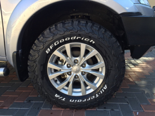

Ok so went shopping this morning and got the 265/70/17 so I nice increase in profile from my 65's. It doesn't touch on the inner wall and considering BFG's added rubber any other 70 brand should be fine. Only done 5km back to the house but ride seems nice and a bit softer. We'll see how it goes off-road but not planning a trip for a few months

Have you noticed any difference in the gearbox, especially on freeway cruising where it might be more reluctant to lock up overdrive due to the bigger tyres?

Michael, looks good.
Do you have the standard suspension?

Cats - took it for a short drive on the freeway this morning and too be honest could feel any difference in the gearing. I was checking speed and before the new Tyres my true speed was 113 when my speedo read 120 now my try speed shows 117 - so slight difference.
The one thing I did notice is that a slight more effort is involved to move off from a stationary position but really slight
