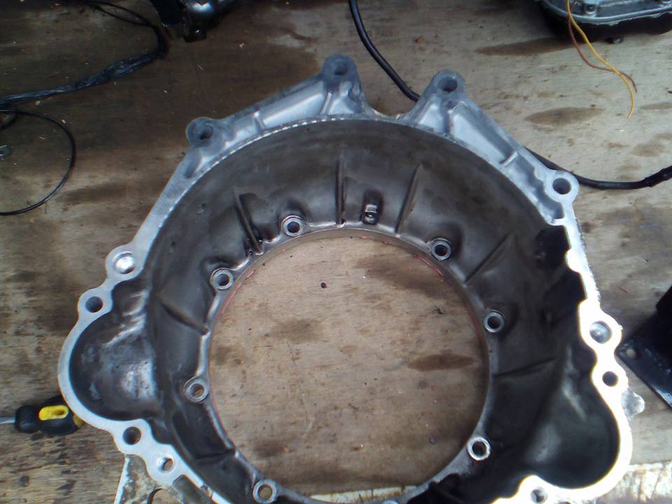

I understood that the bellhousing of the V8 Automatic transmission fits on the Pajero auto transmission.
That didn't work out for me doesnt fit
They say its possible to swap the primary shaft is impossible is totally different.
Now i am looking at my options.

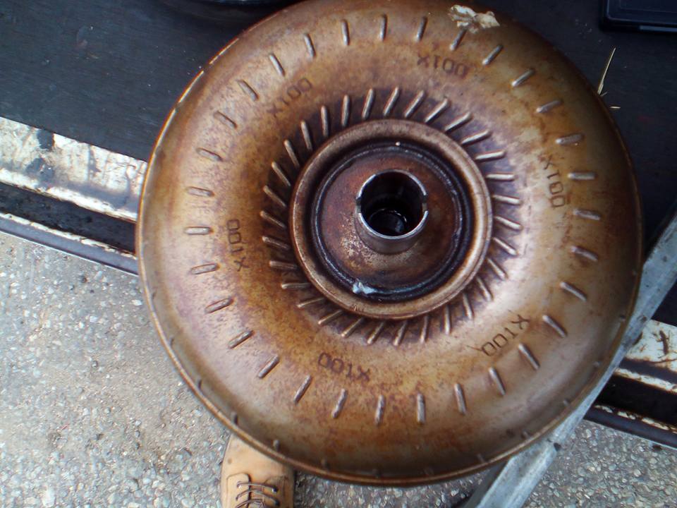

Will use Pajero auto transmission but make or source an adapter plate to fit the Lexus Bellhousing.

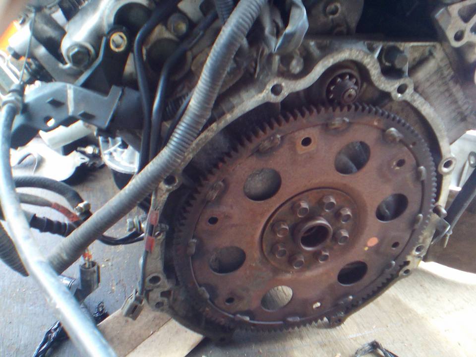

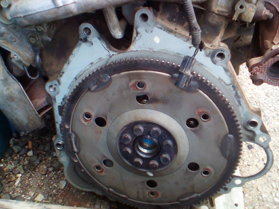

And also need to modify the Lexus flexplate to accept the Pajero torque converter.
Questions.
1. Did any of you have this experience and what was the Solution ?
2. Is there such adapter plate available for the Pajero auto transmission to fit the Lexus Aisin auto transmission Bellhousing.
See pictures below.

I am working on my 1UZ Swap from a Toyota Celsior going into my Wide Body LWB 1997 Mitsubishi Pajero 3.5 GDI.
Was expecting an walk in the park with the mating of the transmission to the engine but things are slightly different in reality.
1. It was said the Lexus Bellhousing would fit straight onto the Pajero Transmission but that is not the case the diameter of the Pajero bellhousing mating surface to the box is 245mm the Lexus about 215mm.
In order to make an adapter plate it will need to happen at the
a. Engine side or
b. Cut part of the Pajero bellhousing and have this welded to the Lexus belhousing.
2. I want to stick with the Pajero Transmission as it is a strong problem free transmission.

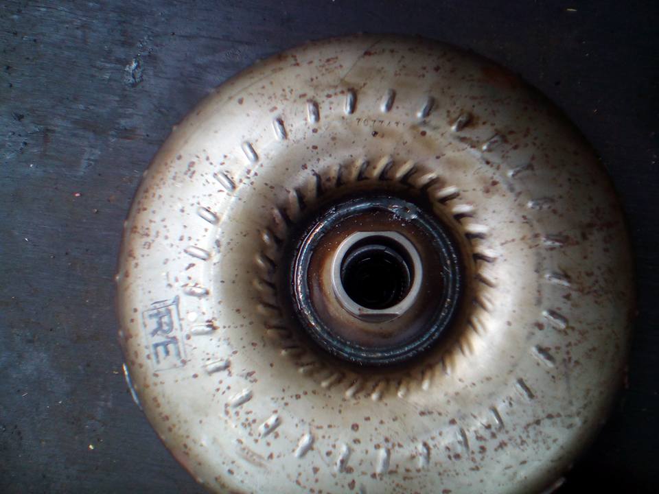

This means will need a custom Torque Converter. I am hanging more to usingthe Pajero Torque converter and have the bolts locations as per the Lexus flexplate welded on and balanced.
Questions
a. Who can assist in making / modifying the Torque Converter to fit on the Lexus flexplate.
b. We need to not forget the dept of the primary shaft coming out of the transmission that the splines line up properly.
c. That the centre point which is different on the Pajero Transmission needs to be machined and possibly welded on to fit the Lexus Flexplate.
Looking for advise how to get around this little hurdle.
See pictures for reference.

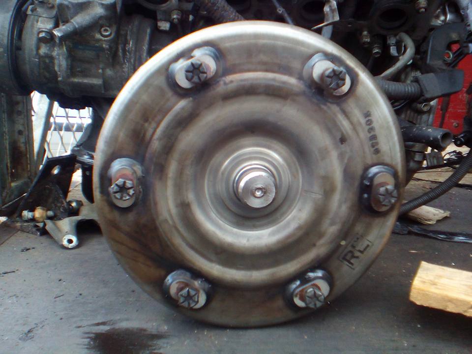

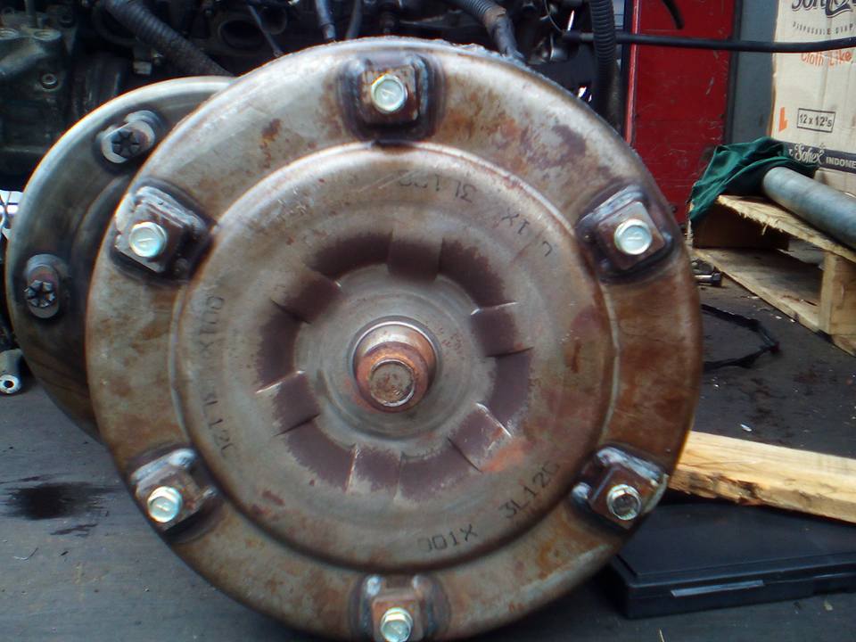

Hi Paul just saw your post I stored the project for a while but have made the transmission adapter plate.
The modified Torque converter
I only need the wiring diagram of the Transmission and ecu pinout to wire it to the Lexus ecu.

Nice. But I'm really interested in the adapters you build. For which gearbox were they?
I hear it's hard to mate the Lexus engine to the v5a51 box (common on automatic GDIs)
I would love if someone has done it
