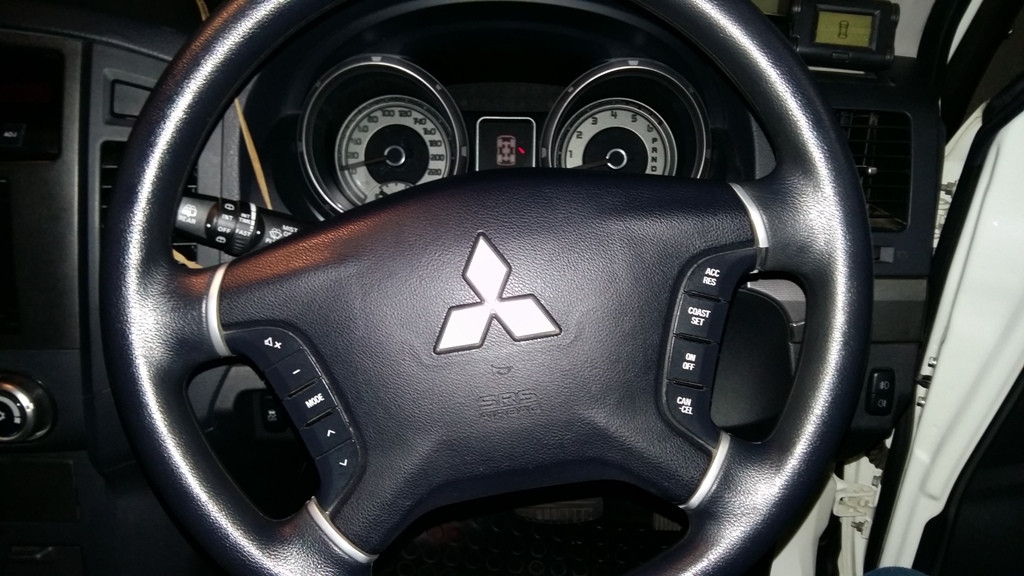

Mine has the steering controls retrofitted!
Apparently you can buy them, unclip the dummy covers on your current steering, plug in the controls and voila! Wiring is already there in the GLX!
Maybe pop in at a dealer and ask before swapping the complete steering.
