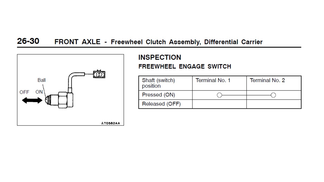

Hi 4ePikanini
I have been doing more homework and I plan to check that sensor. It appears to be a very mechanical switch with a ball bearing that pushes against the shaft. I am driving to Cape Town next week so will leave things for now. I have also cleaned the ABS sensors on the front wheels and checked the vacuum relays just below the air filter. I will see if any of this has helped on my travels to Cape Town.
Front free wheel Sensor 01.pdf
(93.22 KiB) Downloaded 1169 times
Re: Not staying in 4H - Front Lights flashing
Hi 4ePikanini
(93.22 KiB) Downloaded 1117 times
