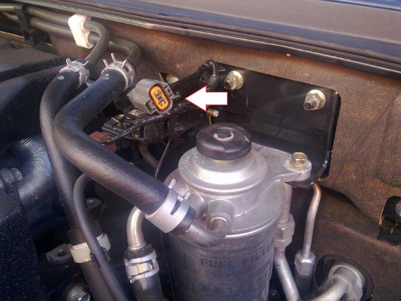

In addition to that I found another switched feed which is unused at the momen but before using it I would like to know what it is. I don't want to cause problems! Have a look at the attached pic to see if you recognise it.
Many thanks
Bruce

I have a similar connection in that location for my gen2 petrol. If I connect 12v to it, it runs the fuel pump. Yours might be similar.
