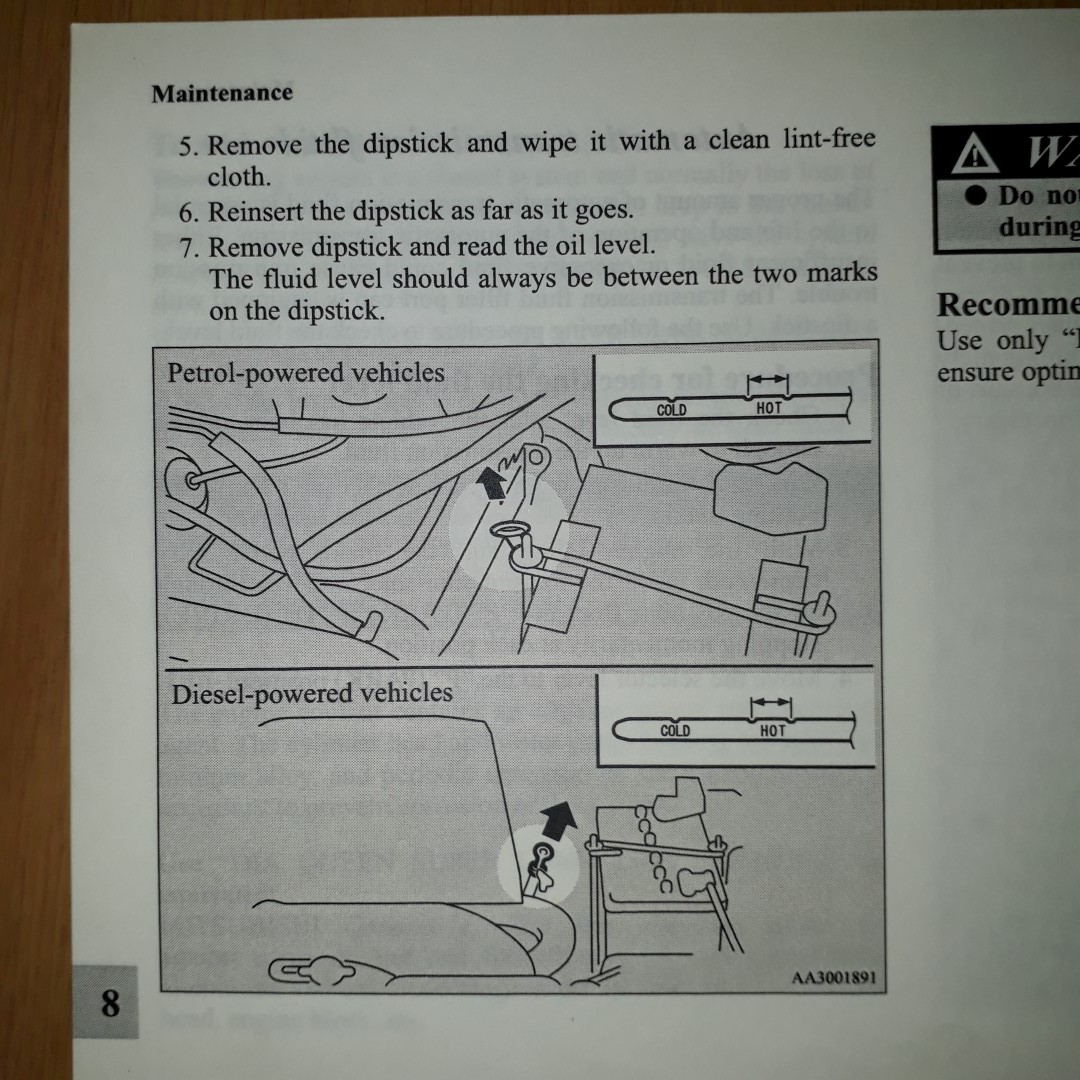

macjohnw wrote:
4ePikanini wrote: NOTE : The level must be checked while car is parked on level surface. It must be idling and the box in neutral..
I see my manual says the car must be in park, while idling, in order to check the level. Or am I mistaken?
My service and owner's manual says otherwise.

macjohnw
Re: Gen3 : DIY - Auto Transmission fluid change
Fri Jun 10, 2011 11:52 am
Here is my owner's manual:

That's bizarre. Either......
it's a printing mistake
or park and neutral is the same gearbox fluid wise
or they got a lawsuit from an certain country (known for suing) after the vehicle rolled off a cliff while in neutral. :lol:
I'll check the level in both positions next time and see if there's any difference.
