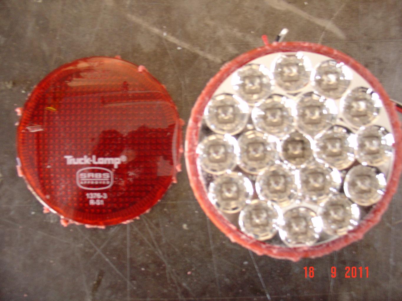

Hi Guys, Been a bit busy and away on business. As promised some pictures:

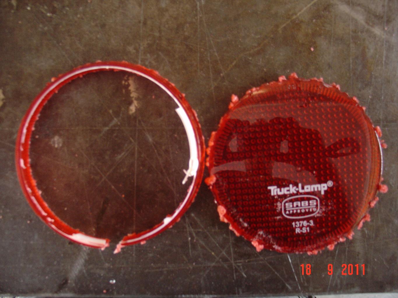

Carefully cut off the lense. I used a dremel.[
then remove the ring

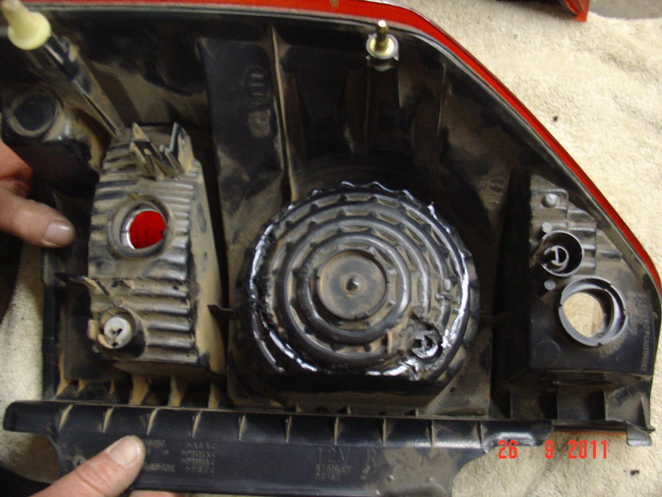

Use the ring from the truck light to mark the position

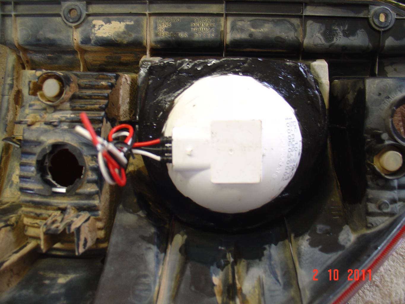

Once the hole is the correct size and after cleaning the inside of the lamp. Silicon the lamp into position

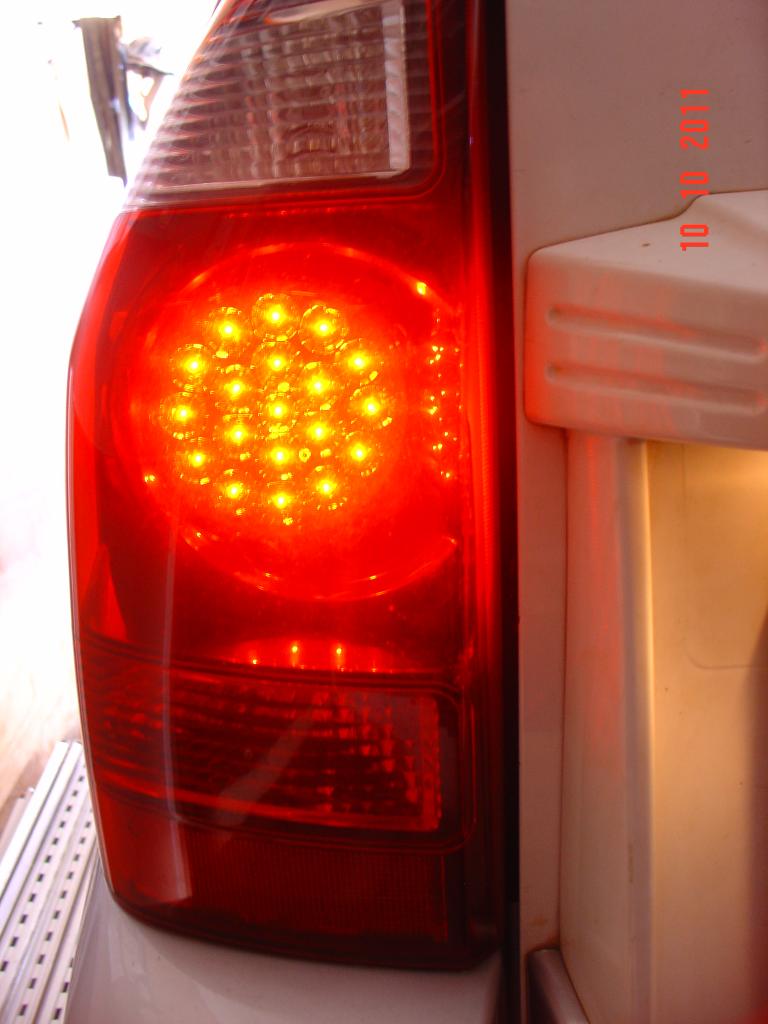

I was using globes before this mod, so the wiring was already there. You can buy the terminals for the existing connector at Volvo trucks countrywide.
