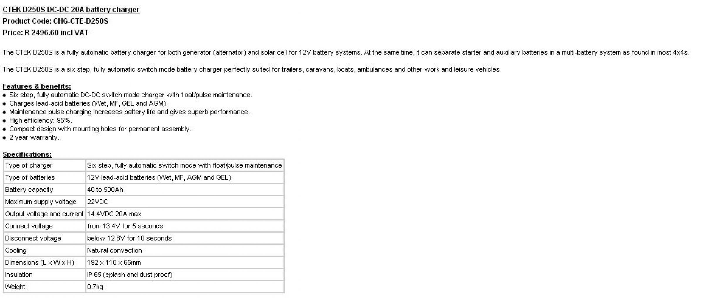

DC-DC chargers are not similar or identical!
I checked the CTek's spec, as listed on Bushpower's Website.
It does in fact state that it will only connect at
"from 13.4V for 5 seconds",
and disconnect at
"below 12.8V for 10 seconds"
__________________________________________________

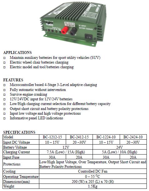

Compare that to the BC Series DC-DC charger:
Input: 10-15V
Cut-out when input voltage is outside these two figures.

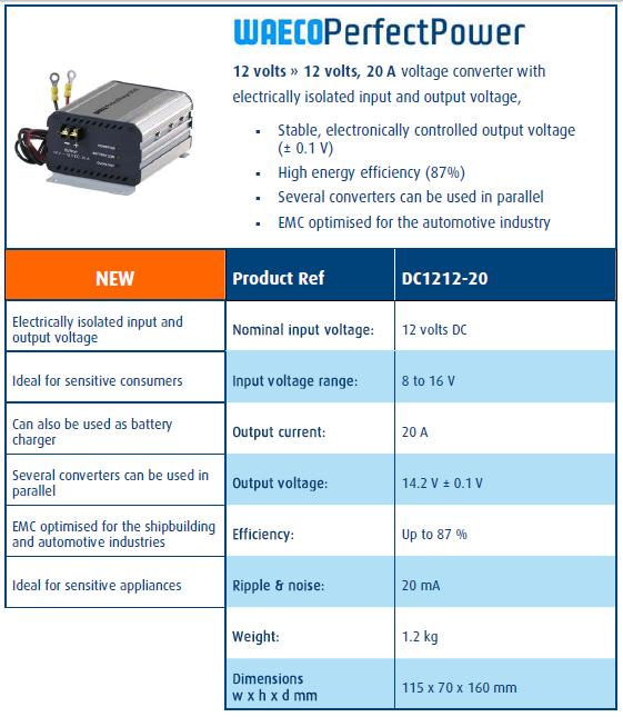

Another alternative is the Waeco:

  • The Ctek DC-DC:
    • This is obviously aimed at being used with an alternator as the input source.
    • The cut-off values make it impractical to use with other "12V" sources.
    • The low cut-off makes it risky to run 'thin' cables/wires to the back of your vehicle - the voltage drop might just be enough to prevent it from connect. THIS DEFEATS THE OBJECT OF DC-DC CHARGING!
    • The intelligent charging is a benefit.
  • BC Series:
    • This unit has intelligent charging.
    • The low and high cut-off values for the input source means that it can be used as an effective, intelligent charger, using ANY '12V' source, such as
      • alternator,
      • other batteries,
      • 'dodgy', cheap battery chargers,
      • cheap AC-DC converters
  • WAECO:
    • NO intelligent charging.
    • The low and high cut-off values for the input source means that it can be used as an effective, but NON-INTELLIGENT charger, using ANY '12V' source, such as
      • alternator,
      • other batteries,
    • Provides a constant 14.2V output, with up to 40A current.
    • Acts like an alternator!
My choice?
The BC series, for the fact that it can use 'dodgy' input sources to provide intelligent charging.
