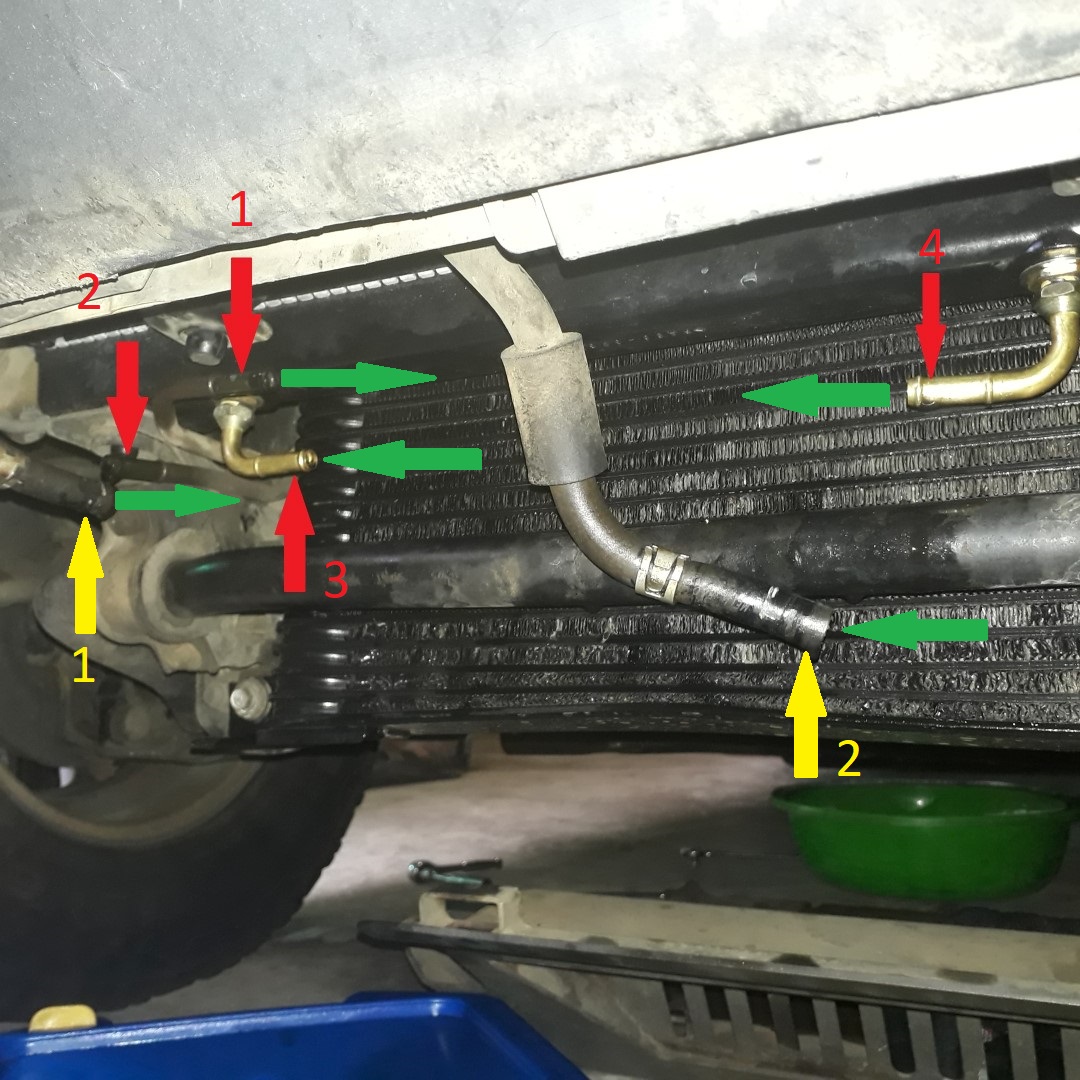

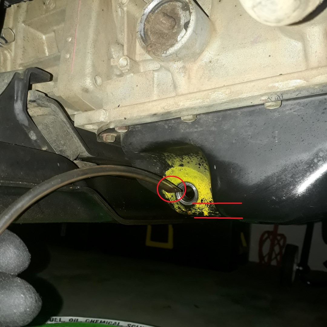

Thanks for a good thread Marius. I drained and flushed my auto box this week - here are a few things I can add, if not already mentioned:
1 - I pulled off all the rubber front hoses to drain the cooler and other gearbox pipes (1st pic).
2 - I used a plastic transparent pipe and drained all the ATF from the gearbox, by sucking out bits at a time and then blowing it into the oil pan. If you only take out the drain plug, there is still some ATF left that sits just below the drain plug hole. It is a fair amount of oil, if you want to properly drain out dirty ATF, like in my case (2nd pic)
3 - I bought cheap ATF from Midas, filled to the required level and then drove around for a short while. I then repeated steps 1-3 above. I now need to drain it again to see if the ATF is clear yet or not.
I ordered the filter and will install as soon as it arrives.
Pic 1:
Green arrows shows flow direction
Red arrows the steel pipes/fittings
Yellow arrow No.1 - top of oil cooler pipe
Yellow arrow No.2 - bottom of oil cooler pipe
Pic 2:
Note the scew cut on the front of the plastic pipe, enables you to reach the last little bit of oil
