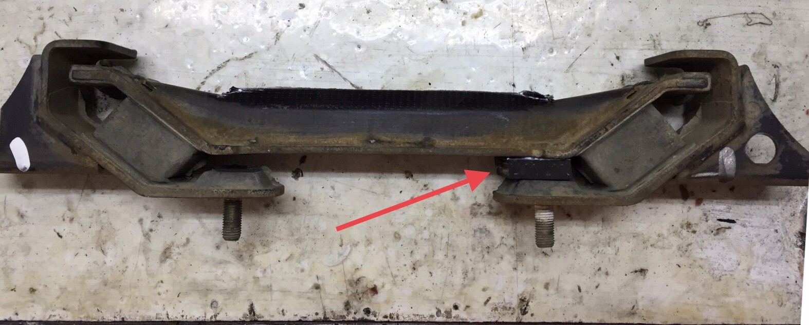

Hi there. I have also experienced the difficulty of getting the car out of gear when parked, especially on an incline. I also have the clunk when changing from reverse to drive and back. I have been advised that I should ignore the clunk as it is caused by a stretched chain in the gearbox and would cost a lot to repair, and this appears to be a consistent problem with auto Pajero.
To address the difficult gearbox changes, I have made an alteration to the gearbox mounting which costs nothing and should take max 1 hour to do. I postulate that the difficulty is due to there being too much play in the mounting due to the rubber deteriorating over time.
I have inserted a square of rubber under the mounting which makes the gearbox ‘flex’ less.
See picture.
You have to support the gearbox and remove the mounting. I was under the impression that gear changes were smoother, but, I have not been able to test due to lockdown.

Re: Diff Clunk and Tight Gear Shifter
Hi,
I have been experiencing the same problem on an incline in my 2000 model 3.2 Di-d Shogun, how was the
result of your upgrade on the transmission support? Thanks, Boyet

Hi Ernesto. In my opinion, the gear changes are are smoother and quicker. It did not solve the clunk, but, it’s worth the effort and something that you can do for free.
